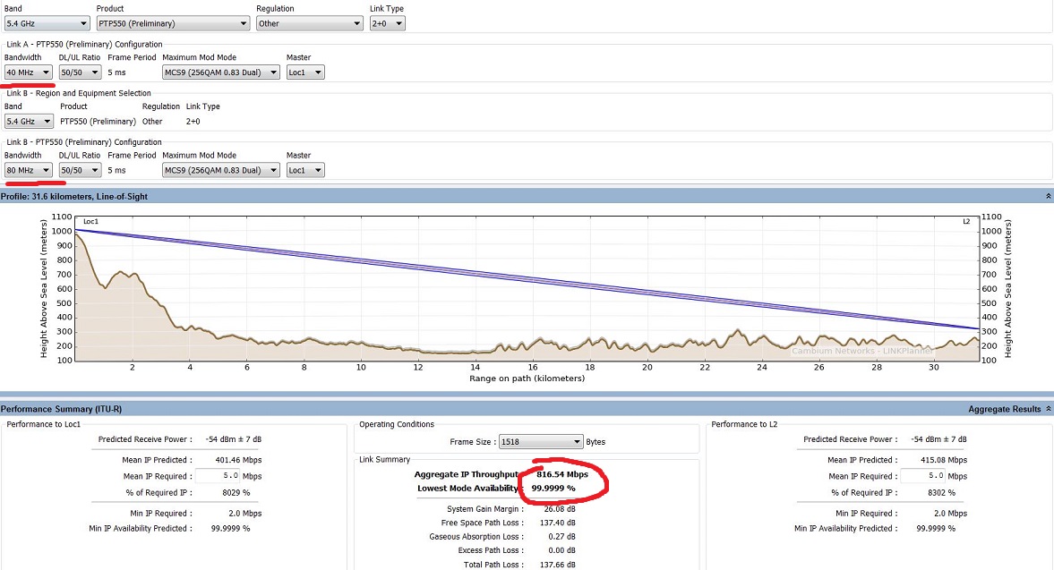

Here is roughly what you could expect from the link on 30 km. You can play with simulation yourself in LinkPlanner, it's free for use.
90 cm dish antenna on both sides, 2 x 40 MHz channels size
Estimated Aggregate IP throughput 552.24 Mbps
120 cm dish antenna on both sides, 2 x 40 MHz channels size
Estimated Aggregate IP throughput 597.61 Mbps
90 cm dish antenna on both sides, 1 x 40 and 1 x 80 MHz channel size
Estimated Aggregate IP throughput 816.54 Mbps
With 2 x 80 MHz channel size, considering spectrum allows you to use it, you can go over Gigabit.
