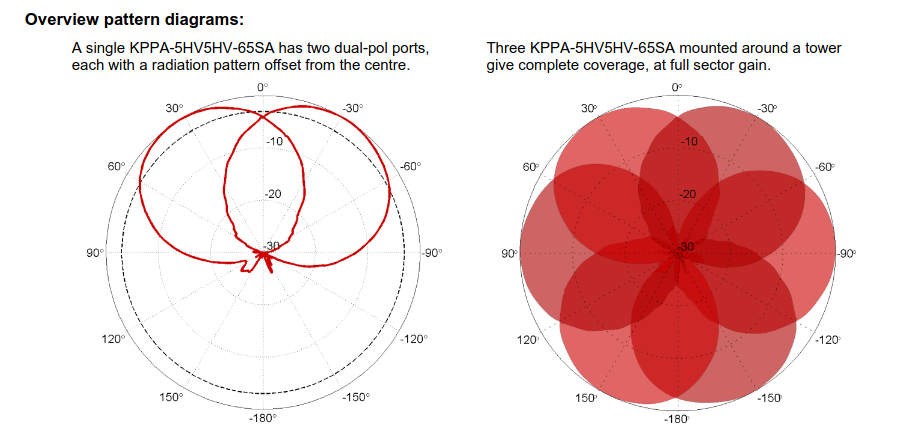

Just wondering if anyone has used a 4500c in omni mode where there is a bit of overlap between sectors. We have a tower with 3x KPPA-5HV5HV-65SA (https://qa.media.kpperformance.com/products/datasheets/KPPA-5HV5HV-65SA-datasheet.pdf) which is a dual 65 degree sector in a single radome. The plan is to wire two of these antennas to a single 4500c to get 240 degrees of coverage in omni mode.
I think I was reading that there shouldn’t be substantial overlap between coverages, but that’s not going to be possible to avoid using these antennas since the overlap is fixed.
Should I be just using 4x 4500l or will it be fine? Got about 30 subs to swap over once the tower work is done and I don’t want to have to climb again if it doesn’t work out :stuck_out_tongue:
