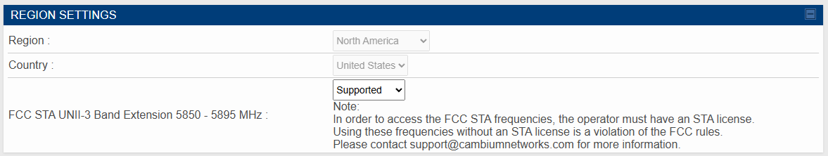

We use 25.0.1 across our network and it seems to work well. As to interference mitigation, IIRC, 450m uplink interference cancellation was introduced in R22.2 and then later on in R24 they removed licensing restrictions, so it’s free to use. If enabled it supposedly helps with mitigating uplink interference at the cost of disabling uplink MU-MIMO benefits (uplink data is sent in SU-MIMO). In our testing we did not find any instances where enabling interference cancellation resulted in better uplink tput. ALSO of note, not sure when they introduced this, but as of newer firmware, you no longer need a special STA build to use 5.9GHz channels.

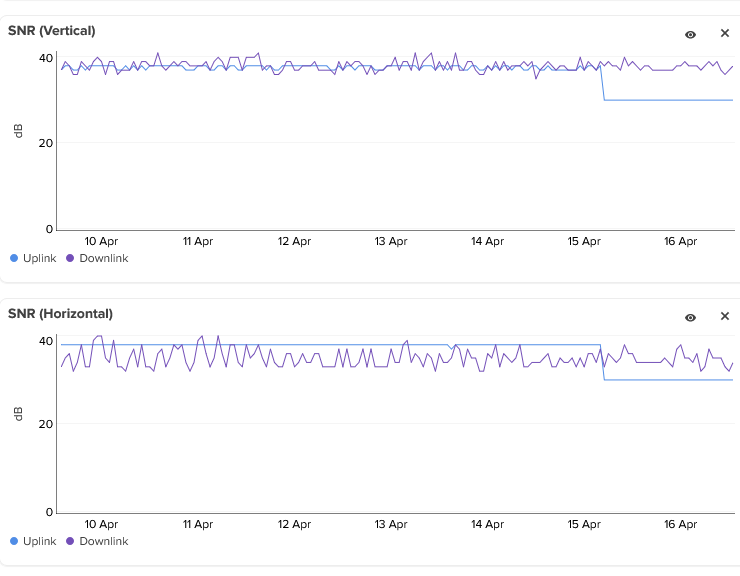

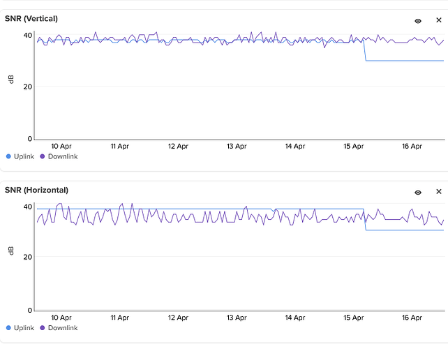

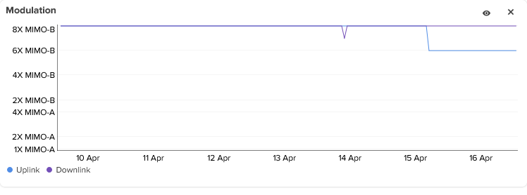

Hi, We tried to change firmware on our PMP450m from 24.2 to 25.01 but after that the uplink on all antenna go from Mimo 8 to 6 and SNR from around 38 to 30dB ? Is there any reason for this ?
