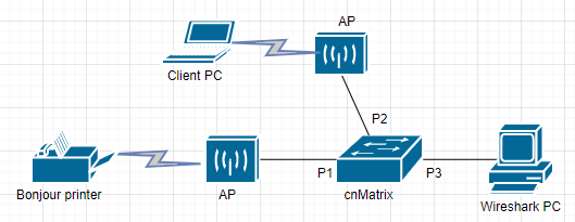

By default cnMatrix does not block multicast packets used in the Bonjour protocol. You can enable port mirroring on cnMatrix to capture the Bonjour packets transported via the switch as shown in the example below.
To configure port mirroring on cnMatrix for capturing traffic on ports 1 and 2, use the following CLI commands (diagram below):
(Note: Wireshark PC is connected to port 3)

(output should look like below)
 Session     : 1
Source Ports
   Rx              :  None
   Tx              :  None
   Both            : Gi0/1,Gi0/2
 Destination Ports : Gi0/3
 Session Status    : Active
