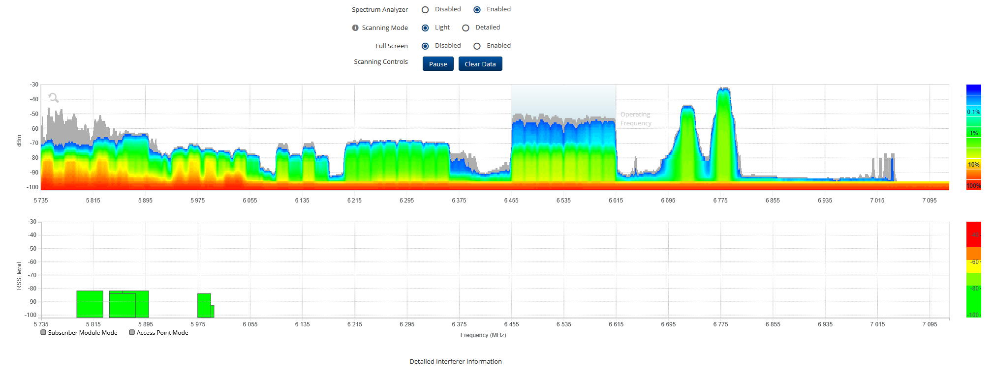

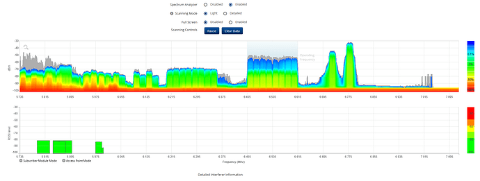

I suggest you to Raise Ticket in the top right corner of this page and attach Tech Support Files from AP and CPE right after the connection problem occur again. Before Tech Support Files download, please enable and execute Spectrum Analyzer.
Raise a support ticket is free. Our Engineers will investigate and help with your issue.
We have already opened a support ticket, and the last advice we received was to enable the watchdog (which I didn’t really understand). My colleague reopened the ticket this morning. In terms of interference, the situation doesn’t seem hopeless, and it looks suspicious that the affected endpoints are specifically the ones farther away.
