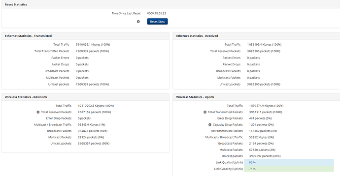

On The Uplink I Have 0 Error Drop Packets And A Very High Number Of Capacity Drop Packets
What Causes Capacity Drop Packets ?

That is what i thought but I get those capacity drops even when I am just idling not downloading or uploading anything. just PC connected to the sm! sm is on bridged mode . failing to understand why this is happening
The radio has processed 1.5 GB of traffic with a 4% retransmission rate. This suggests potential interference, preventing the radio from successfully transmitting all data packets in real-time. To stabilize the link and reduce retransmissions, we recommend capping the UL MCS level.
the retransmissions i get rid of them by limiting mcs to DS MCS 4 - 16-QAM 3/4
it’s the capacity drops that i have a problem with cause even when there is no upload activity they are there. idling the radio for 30mins i find capacity drops at more than 1000 packets
