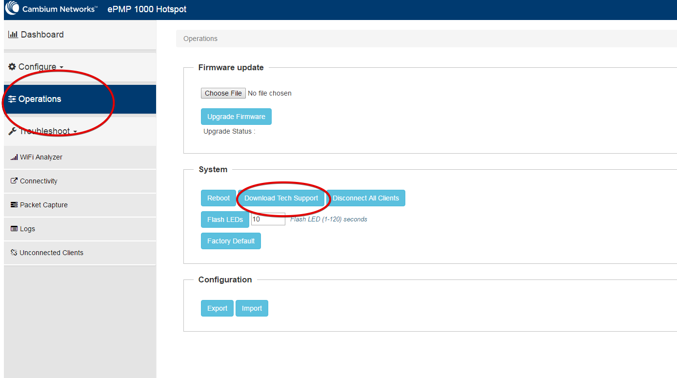

You can download the techsupport file from either cnMaestro or Device GUI.
If the device is down in cnMaestro then please download by login to device GUI.
Please find the screenshot attached.
