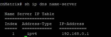

How are you getting DNS resolution? Perhaps you should use some caching DNS, like Google's 8.8.8.8/8.8.4.4.
Hi Resham,
It looks to me your cnMatrix does not have DNS server or default gateway to reach the DNS server. Do you use static IP address or dhcp for the switch?
Please attach the output of the following CLI commands:
show system info
show int des
show ip int
show cnmaestro (for 2.0.5 release) or show device-agent (for 2.0.4 release)
show ip route
show ip dns name-server
show cnmaestro log (for 2.0.5 release) or show device-agent log (for 2.0.4 release)

Hi Tam
Attached are the screenshot for you reference.
Regards,
Resham
Hi Tam
I am using dynamic ip for the switch.
Remaining screenshots are attached:
Regards
Resham
Hi Resham,
The switch is running 2.0-r1 which must be upgraded to the latest release 2.0.5-r2 from Cambium support site. Also, the configuration appears improper. Please contact me at tam.nguyen@cambiumnetworks.com for further assistance.
