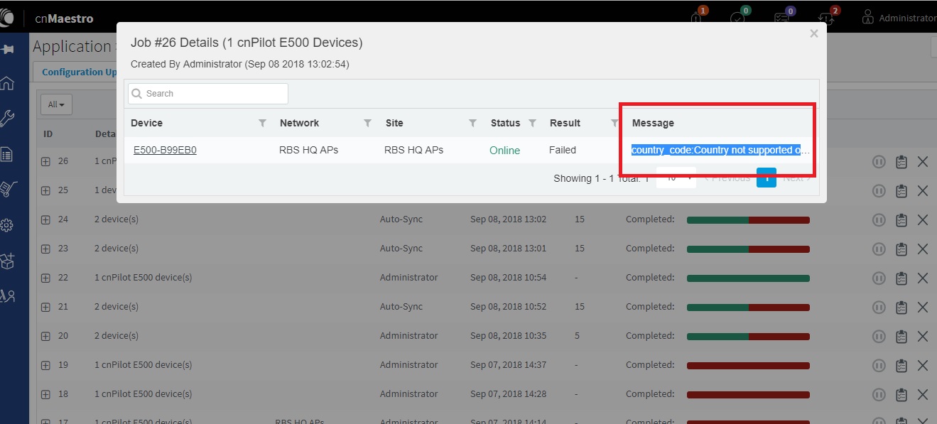

Country_code Country not supported on this SKU / Failed To Push Configuration To Device
Gents ,
Need your advice ..
I m from Myanmar . My cambium cnPilot E500 AP with Software Version - 3.5.2-r4 . Failed To Push Configuration To Device via CnMaestro and Error is country_code Country not supported on this SKU . There is Myanmar included in Country-Code and i choosed Vietnam . But sucessfully to syn in E401 with Software Version - 3.5.2-r4 and selected countery code is other . Any advice ????

Myanmaar country code support is not avilable in CnPilot AP's. Same will be available in upcoming releases.
While Myanmar is not supported, it is still possible to use your cnPilot device legally according to the regulatory domain in Myanmar.
You just need to be aware of the allowed Channels (in both 2.4Ghz and 5Ghz) and allowed transmit power. Once you know this you can adjust the settings on your device accordingly.
