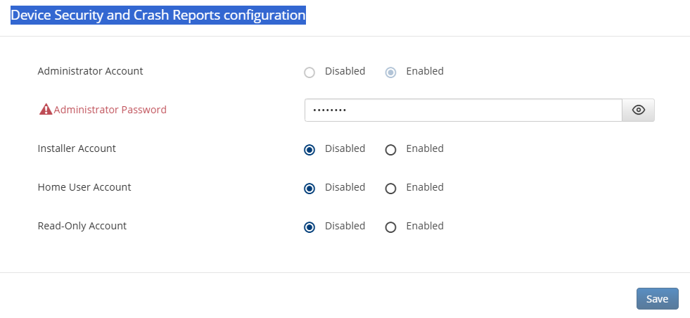

Dear Sirs, I’m having a problem. I updated an EPMP 180 FORCE antenna to the latest firmware version. But I didn’t take the precaution of changing the password first. Now I’m getting a password change window that says “Device Security and Crash Reports Configuration,” but no matter what I enter, it doesn’t enable the button to accept the change. I need some suggestions. Thank you. I’ve attached the screenshot I’m talking about.
Hey TECNICOMEDINA1, did you get this resolved? I have just experienced the same on a PTP550 after upgrading to 5.10.3.

Figured it, just change the password obviously.
Hello @TECNICOMEDINA1,
is your radio row? I mean not locked for ETSI or FCC?
Did you upgrade it to 5.10.3?
Did you try some complex enough password? Like @Dmin1234
