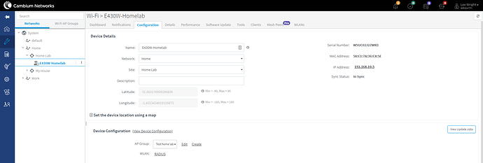

You don't have to remove the device from cnMaestro to move it to a different site or new AP group. You can go into the configuration of the AP and select what site the AP belongs to (screenshot below):
