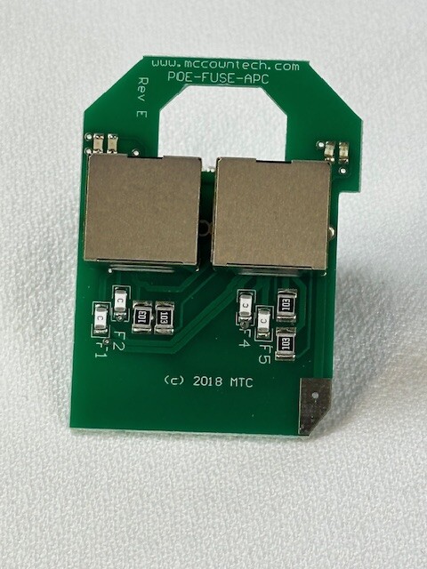

I suppose I could try to be helpful here… This is what we use for our tower sites that then go to netonix switches. There are fuses because of the Netonix being grounded and having its own suppressor that will clamp all the lines = blown ports.
Here is their surge suppressors https://www.mccowntech.com/product-category/rack-mount-surge-fuse-and-dc-protection-products/

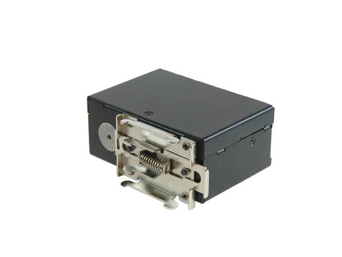

Then we put them in these.
Now we run a bunch of different platforms with different requirements so we found the flexibility of this platform to work well for us.
