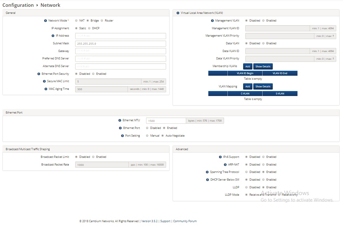

Under configuration network, management access…
I don’t think epmp had a timeout setting on it

@Doug Heberlee wrote:
Under configuration network, management access...
Ah, good, OK. :) I knew it was there. I had to clear my cache and I see it on the AP side now. I think I may have been looking at the slave side at one point, and it's not in the SM/Slave GUI, and I think that's where my brain-fart started. Thanks. :)

Management access option is in the slave also.
Hmmm... this is what my 3.5.2 CONFIGURATION - NETWORK says when configured as a SLAVE, and I don't see that setting. However, the SLAVE seems to have it on automatically - I can access it's GUI from the Ethernet side (of course) and I can access the SLAVE's GUI from behind the MASTER/AP - which is fine. The problem I was having was being unable to access the MASTER/AP's GUI from behind the SLAVE/SM, but your guidance helped me find that setting. :)
