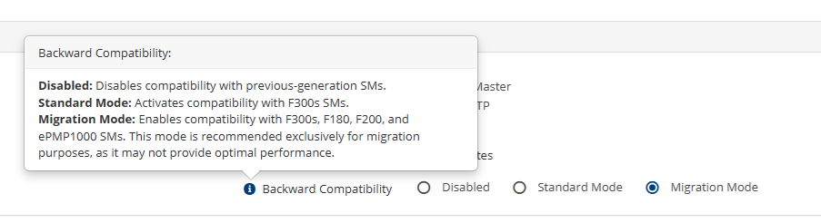

I would want more details on this one, we had customers call in because we had the Access point in migration mode with older SMs, would they not notice it anymore or is there still a hit on performance for these older SM?
AXG-11713 (All): Improved performance for backward compatibility mode with N-gen SMs
Thanks!!
Patrice
There are still some issues with legacy N clients with an e4k AP set to “migration mode”. Sometimes all clients across the AP will experience high latency/jitter and poor throughput, despite having excellent modulation. A reboot of the AP & SM’s temporarily resolves the issue. Migration mode is not intended for long-term use. We typically will swap out these legacy N clients for F4525’s as soon as possible so that way we can disable migration mode.
