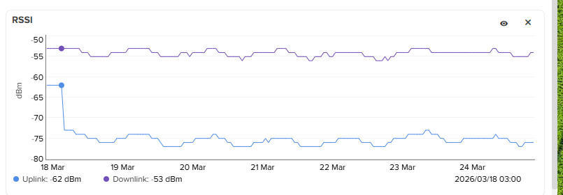

I am still seeing on a couple 4625 radios where anything above 5.11 rc54 has a horrible upload signal versus anything RC54 and lower.
Just installed one new out of the box and on 5.11 the upload signal at the AP at 11 DB transmit power was negative 74. downgraded to RC 54 and the upload signal at the same transmit power on the AP side was -60.
So far I have seen this on two 4625 SMs that were installed in different times so they should be from different batches. I have not upgraded all my hundred plus SM’s to 5.11 yet so I’m not sure how widespread this issue is.

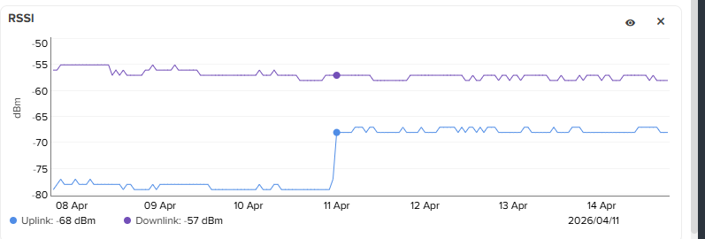

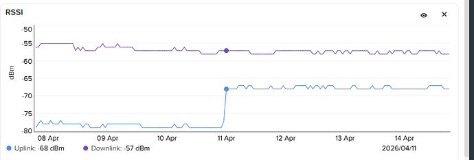

I can provide you with some support files, I just downgraded the SM to 5.10.4 leaving the AP on 5.11 and that fixed it. Here you can see the reduced signal on upgrade to 5.11 and jumps back up to normal on 5.10.4.I have not attempted to update again to 5.11 Although I have been watching for comment on this thread. https://community.cambiumnetworks.com/t/reduced-signal-strength-on-5-11-0-rc63-beta/108232/6
Have you tried upgrading to 5.11 RC54 beta? For me on SMs that do this any version 5.11RC54 or lower are fine. Any version 5.11RC63 or higher have the bad upload signal.
So something changed between RC54 and RC63 that is triggering this in select 4625 SMs.
