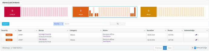

So, inconsistent and inaccurate.
Today, cnMaestro is showing 5 major alarms of devices offline when in reality, none of them are off line.
Following up on this thread. Not sure where development is.  I have two devices off line but they are not reported as critical or major alarms:
