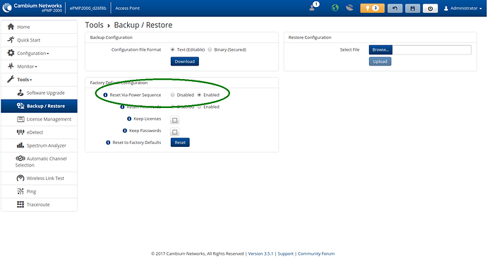

Hi,
Please disable reset via power sequence option on UI.
Thank you.

Not sure about CLI, but I’ve done it on cnMaestro and scheduled to run early in the morning.
“device_props”: {
“powerSequenceFactoryDefault”: “0”
we defaulty disable the reset sequence across the board, but its likely your best solution is to address your power issues. A cheap UPS or AC power filter should resolve the cause and lengthen the life of your PSUs and radios
