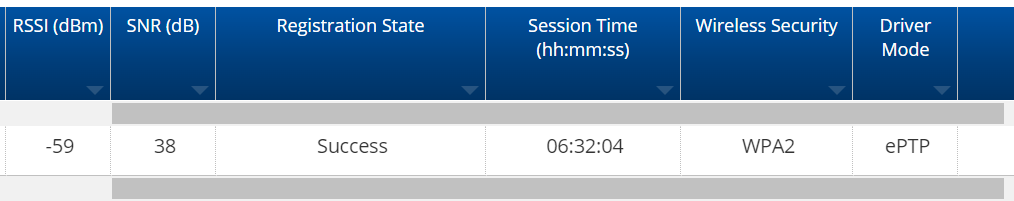

Edit: @aka Unfortunately it is still acting up but the chains and signal are good. Getting poor modulation. Here is the masters wireless tab…
Here is the Slave…
