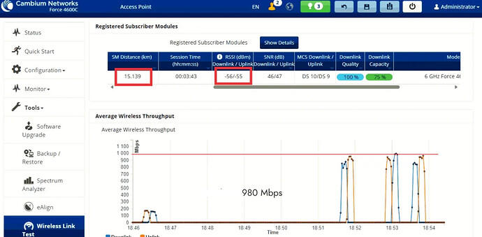

Backhaul Experiences with Force 4600c
Performance and Distance
The experiences with the Force 4600c for backhaul have been very positive, covering distances from 17 km to 30 km. For optimal performance, it is crucial to align using a 20 MHz channel width on a mid-to-high frequency (starting from 6700 MHz). This helps in determining the beam width depending on the antenna’s aperture. To keep the chains balanced and minimize degradation when expanding the channel width to 160 MHz (in accordance with the country’s regulations), proper alignment is key.

Oh wow that is very impressive, unfortunately most of us in NA will not be able to get that kind of throughput at those distances.
I think we can use larger antennas to reduce the output power or take full advantage of it, I hope soon to have the final tests of some deployments to give you a formula that is good for the growth of ISPs.
