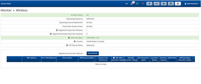

Also, looks like a GUI glitch. The AP showed that it was still transmitting and 1 SM connected when it wasn’t connected and pretty sure it wasn’t transmitting without GPS.
