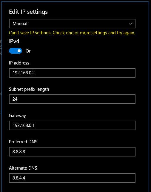

Thanks for the help Divakar. We were not able to connect. We set the static IP on the computer as follows, shown on the attachment. We had the E500 connected by ethernet to the second (Eth2 POE-OUT) port of the E500 device. We then attempted to connect to 192.16.8.0.1 (http and https) using several different browsers. No other network or wifi connections were active.
We have attempted this with two different E500 devices.
