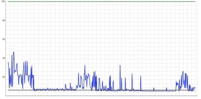

Hello guys,
I set a graphic monitoring of some values from APs.
Green = UL Frame Used (there's a bug in ePMP 1000 and it's always near 100%)
Blue = DL Frame Used
Black = Number of users
I have now 6 users.
Each user have 10/1 profile and MCS14/MCS15.
As you can see, DL Frame Used reached 34.70% 1 hour ago (each point of the graph is 5 minutes from the last one).
In that moment, the total download traffic on the AP was about 20Mbps.
If 20Mbps = 34.70%, and there are only 6 users, does it mean I have to worry about total capacity?
100% would be about 60Mbps in download.
Am I right?
Thank you :)
PS.: How can I monitor real traffic per second via SNMP? I can't find a value for that!
I'm currently monitoring it from the router port.
Can we graph UL/DL frame used as a percentage now?  Is there an OID for this (percentage) in 2.6.1?
No, I made some math manually using PHP+SNMP and the graph is the result of that
Assuming 60 mbps may, or may not be correct. A lot of things come into play when deciding it’s full. If in your performance tab you see “capacity drop” packets, you flooded over. Retransmission, errors nacks and packet size come into play when your talking about a sector filling up. Watching your frame utilization is the best thing, but it’s not graphable directly yet. You can record total available frames, and used frames. You’ll have to do math to see where you sit. Back to bandwidth, you may have one fill up at 55, the next may fill St 80. They unfortunately won’t land in the same spot normally. Unless of course, you’ve managed to get the exact same conditions twice, or everyones locked at mcs15 (wouldn’t that be great!?!)

Sure,
you have to periodically execute something like that on your server (using cron for example), that should be able to reach the Cambium ePMP (so, VPN or an internal server):
$hostIp = '10.0.0.1';
$community = 'public';
$session = new SNMP(SNMP::VERSION_1, $hostIp, $community,3000000,5);
$session->valueretrieval = SNMP_VALUE_PLAIN;
$session->oid_output_format = SNMP_OID_OUTPUT_SUFFIX;
$dlFrameTotal = $session->get('.1.3.6.1.4.1.17713.21.2.1.52.0'); $ulFrameTotal = $session->get('.1.3.6.1.4.1.17713.21.2.1.51.0'); $ulFrameUsed = $session->get('.1.3.6.1.4.1.17713.21.2.1.53.0'); $dlFrameUsed = $session->get('.1.3.6.1.4.1.17713.21.2.1.54.0'); $dlFramePerc = number_format(($dlFrameUsed/$dlFrameTotal)*100,2); $ulFramePerc = number_format(($ulFrameUsed/$ulFrameTotal)*100,2);
//Here you should insert value in a table in a database
Above you have a PHP example, so you should have PHP >= 5.3.3 compiled with SNMP support + Apache/nginx on your server.
Then, you should graph the results you have in your db table (for example using MySQL as your DB) using some graph library, like jQuery RGraph or something similar.
And you should get something like this:
