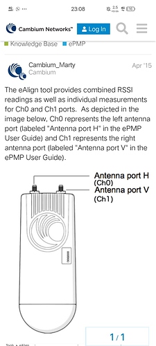

There isn’t really a H and V to the radio as it has no way to know, nor does it care, how you have the antenna oriented. You could connect it to a antenna that is oriented H and V or you could connect it to one where the pols are tilted 45° or you could rotate your H/V antenna 45° .
I’m not sure it even matters if both ends are the same with ePMP as I believe the 2.4Ghz ePMP sector is slant 45° while the subscriber radios are not and cambium said the ePMP radios have magic sauce that allows them to figure out what is what or not care or something.
I am sure that those who say there is no such thing as H or V are less experienced in field work. Because people here most say that there is no way to differentiate between H or V. And I am new to the Cambium equipment problem, but I have tried many radios from other Brands. And no matter it says Ch0, Ch1 or something there must be a sign to know H or V if we want to install using an external antenna. Ummm But i apologize for my rush to ask here, because from the cambium side it turns out that it has posted to differentiate H or V between Ch0 and Ch1.
This is the last time I’m going to comment on this. From a technical/RF standpoint it doesn’t matter which port/polarity you choose. From a reporting/UI/troubleshooting standpoint it’s helpful, but not required, to try to get your ports and polarities matched up.
