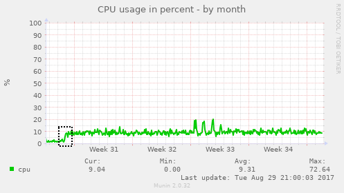

Recently I have found that 2 last firmware updates causes much higher CPU load than usual for some reasons.

Good day,
I have one AP only (E400). No any complex configuration and loads. Up to 15 device connected.cambi1.JPG
Thank you. The screenshots of 'service show top' had one instance of a process at 9% (device-agent) otherwise the AP was mostly idle. Assuming that was a one-off, not clear what is taking up the 10%..
Are you plotting these stats by pulling the data over SNMP? How often is it being pulled, and what is the method of reading (just a couple of specific OIDs, or is a complete MIB-walk being done?).
