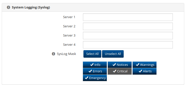

In Monitor >> System log you can see interface up/down events.
You can set up a syslog server to have full event logs. As the radios don’t keep most of events after reboot.
