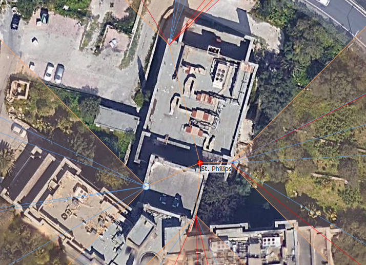

This is a feature request that has come up before and we are happy to let you know that it is already implemented in LINKPlanner from V5.0.0 onwards. You can adjust the mount locations for each radio up to 100m away from the central hub location. The 100m is based on the recommended Ethernet line length from your central switch location.
You can set the position for each mount in two ways:
  • On the Access Point Equipment Page in the Access Point Details pane you can edit the Latitude and Longitude and it will show you the offset from the hub site location, if you later want to put it back to the hub location simply select Reset.
  • Windows users can also move the AP in the Google Maps view, zoom in close to the site you want to adjust select the sector and then click on the white circle and drag it to where you want it to go. With the Satellite view enabled this allows you to place the mounts at the positions you want on a building. It will show the offset as you drag. There is no quick reset on the map view, so if you want to get back to the exact hub coordinates it is easier to use the equipment view.
In both cases once you have moved the mount location if you already have subscribers attached it will automatically request the new profiles to the new location and update the sector.
At the same time we have also added the ability to move the hub site location after you have subscribers connected and to move the end points of PTP links and in each case LINKPlanner will automatically update all profiles.
