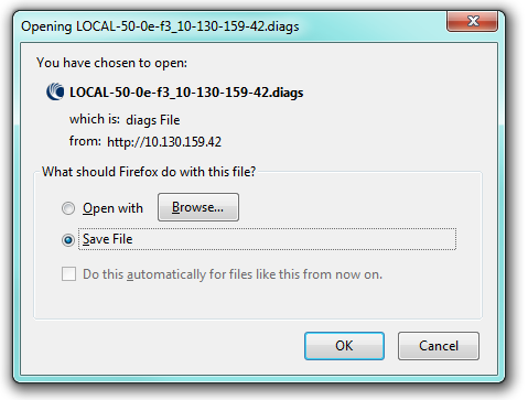

I suggest you gather the field diagnostics file from both ends of the link and send them to Customer Support. If you would like, mention my name and reference this Forum message.
To gather the field diagnistics file, go to the web page at http://aa.bb.cc.dd/field_diags.cgi where (of course) aa.bb.cc.dd is the IP address of your unit. You should see this page:
Click on the button, and you should see this dialog:
Click OK to save the file and then send it to us. The file you generate will be named using the MAC address and IP address of your unit.
