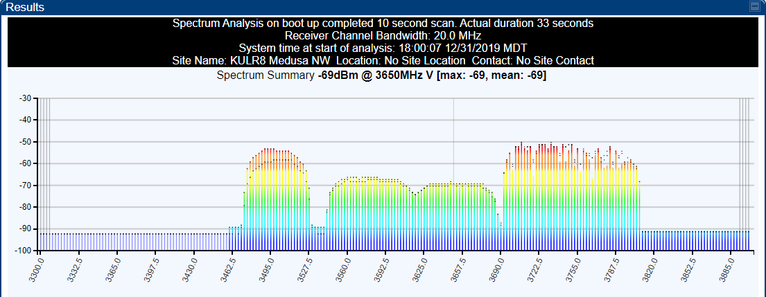

How far can an AP see and AP? We have two tower sites about 9 miles apart. We are experiencing alot of wireless interferecne in the cbrs band. Noise from 3.5 to 3.8mhz
