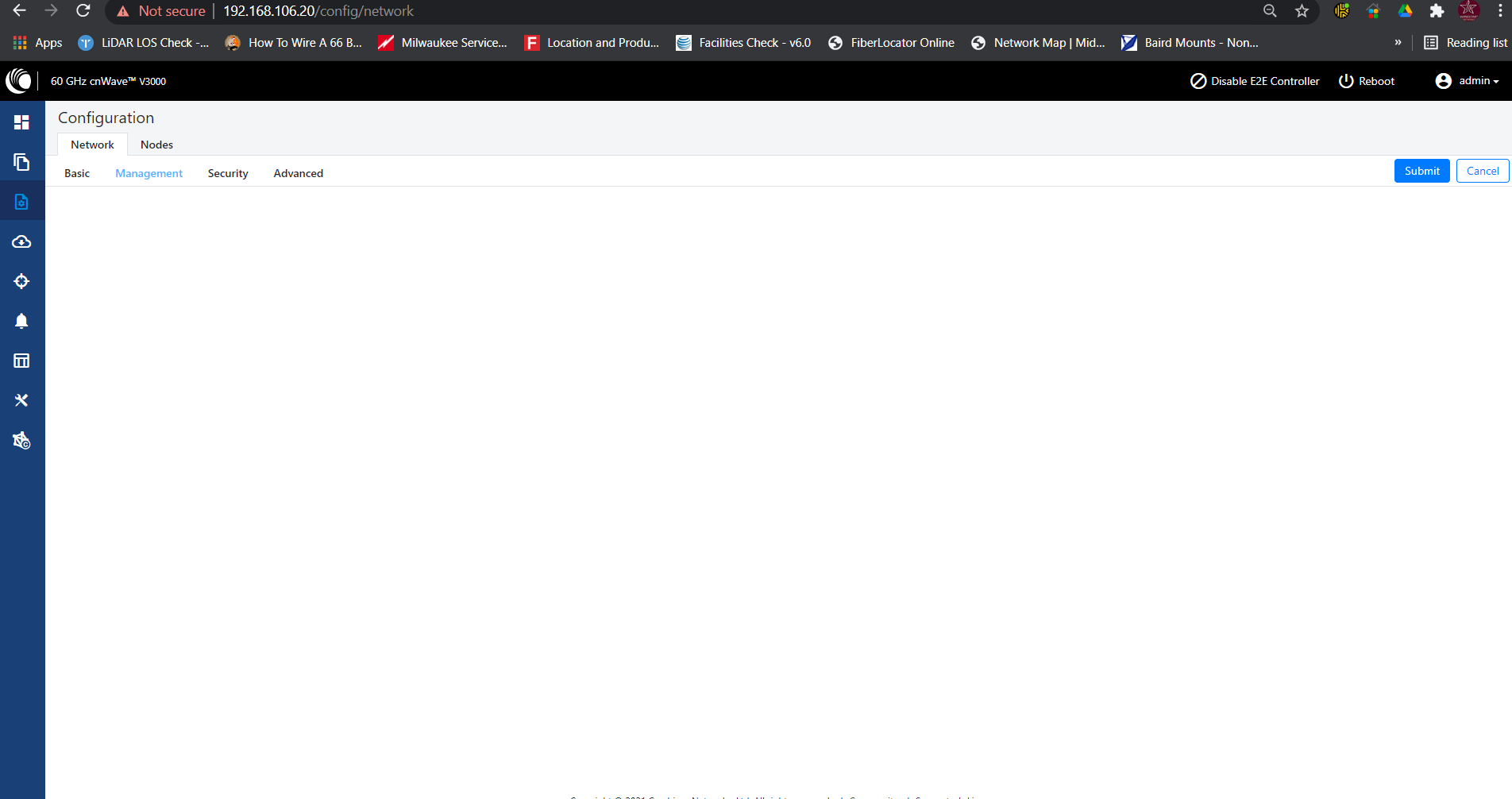

As far as the password - I just updated 2 of my links to 1.1 - I go to Configuration - Management - All i get is a blank screen. :confused:

Oh, that’s unfortunate :frowning:. Do the other sections under Configuration work properly? I know there have been problems with the GUI in Safari on Macs in the past, but it looks like you are using Chrome here. Does it make any difference if you use a different browser?
Update- the 1.1 version hadn’t taken yet when I responded - it finally let me update the password, but here-in another problem. The radio obscures the characters and does not ask for the password to be typed in twice so the user could potentially miss key something and set the password wrong and not know how to get back into the radio.
