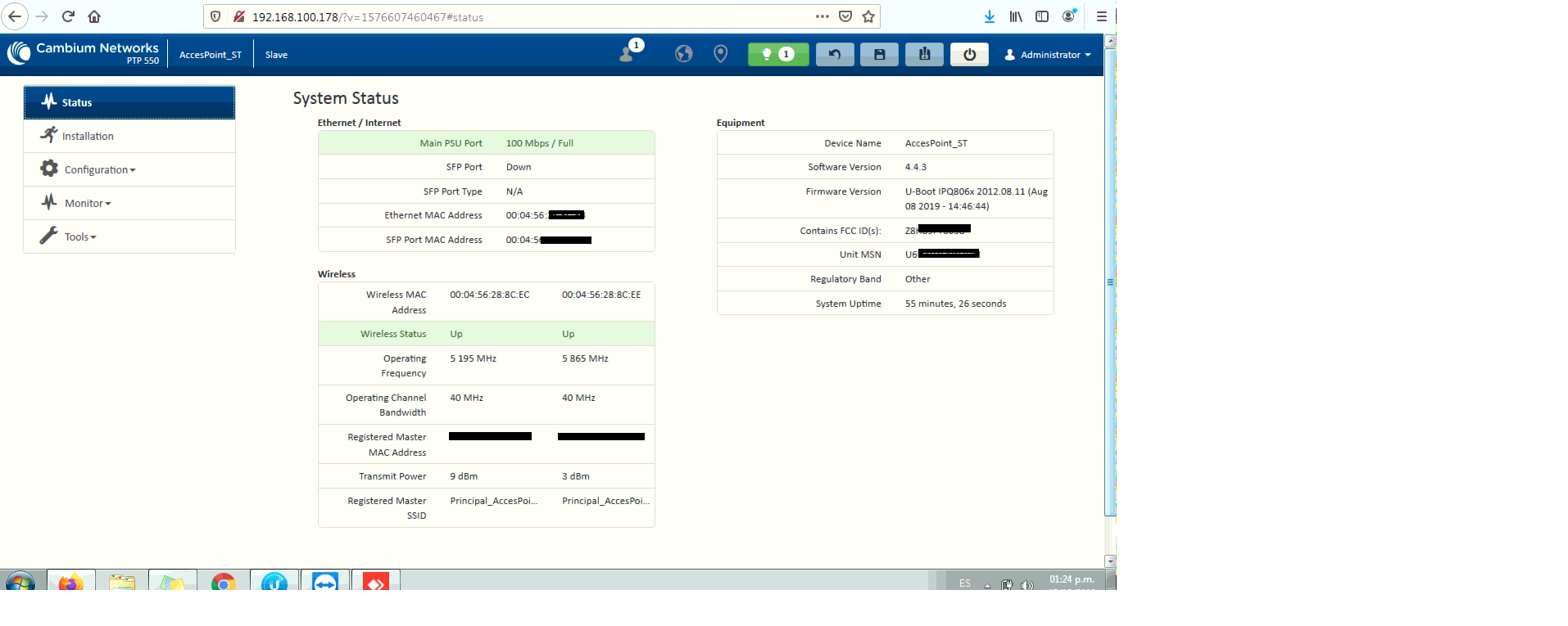

Using version AC 4.4.3 and the problems continue, I cannot spend more than 30 megabytes.
I spend more with a pair of 190 than with these cambium 550,
Totally disappointed of cambium :(
the spectrum and the capture of the station,
Can you see any problem there?
Or do I need to upload capture from another tab?
Wow, the spectrum is trashed... and on top of that you're trying to use 2x40MHz carriers!!
I'd lower down to 2x20MHz carriers, or even 2x10MHz carriers and see if it works any better. If that doesn't work, and you can't put up a licensed link, and you have to use 5GHz, then I'd pull the PTP550's down and put up PTP670's with the biggest dishes you can use.
PS. ALSO try using the newest 4.5 beta firmware for PTP550, you can find it HERE.
