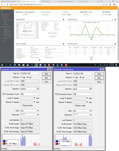

Our Customer in Asia were looking for a product which could deliver throughtput and reliable performance under inference. The trial was conducted over 9 km(5.5 miles) , keeping same antenna, Tx Power ,alignment , Channel freq and channel size..Connectorized Radios were tested and here are the frequency used .
Radio1 channel: 5780MHz, 80MHz
Radio2 channel: 5900MHz, 80MHz
EIRP: 28dBm (Antenna Gain) + 23dBm (Tx Power) = 51dBm
Cambium: PTP550
Uplink: 348 Mbps
Down: 77 Mbps
Aggregated throughput: 425 Mbps (measured from Mikrotik router by generating 100 streams)
Mimosa B5
Uplink: 23.5 Mbps
Down: 136.4 Mbps
Aggregated throughput: 160 Mbps (measured from Mikrotik router by generating 100 streams)
