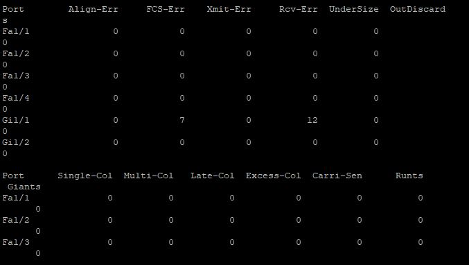

Hello
We have an issue that the network not stable with PTP 450i that connected with Cisco switch IE4000
from Cisco side i see the below error in port Gi1/1 that connected to PTP, so there is any recommended configuration should i apply it in Cisco or PTP
Appricate your help
Thanks
Hello,
Rcv-err counter is typically when the ingress port receiver buffer is full and overflows; generating these errors. May be layer 1 cabling issue.
Typical port configuration
switchport mode trunk
switchport trunk nat vlan xyz
switchport trunk allowed vlan xyz
Cheers
