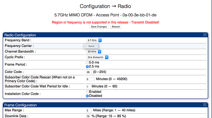

Hi,
It is a 450i unit and can confirm that the cable is correct as per the manual and the brown/white and blue/white cores on the cable are swapped.
I have saved with the correct region (Oceania -> Australia) and rebooted - and tried generate sync but the issue remains.
Some screen shots of the issue -
Hi arobo,
We had not received type acceptance in Australia in time for 14.1.1 release. We plan to open up Australia country code in 14.1.2 release for PMP 450i.
Thanks,
Sriram
