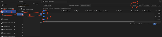

When you login into your cnMaestro account
  1. Go to Inventory > Networks in the cnMaestro dashboard (assuming admin settings is set to industrial like mine)
  2. Identify and select the site where the APs (Access Points) are currently assigned.
  3. Mark all the APs you want to remove from the account.
  4. In the upper right-hand pane of the interface, select the Delete option to remove the selected APs from the account.
Here is the visual:
