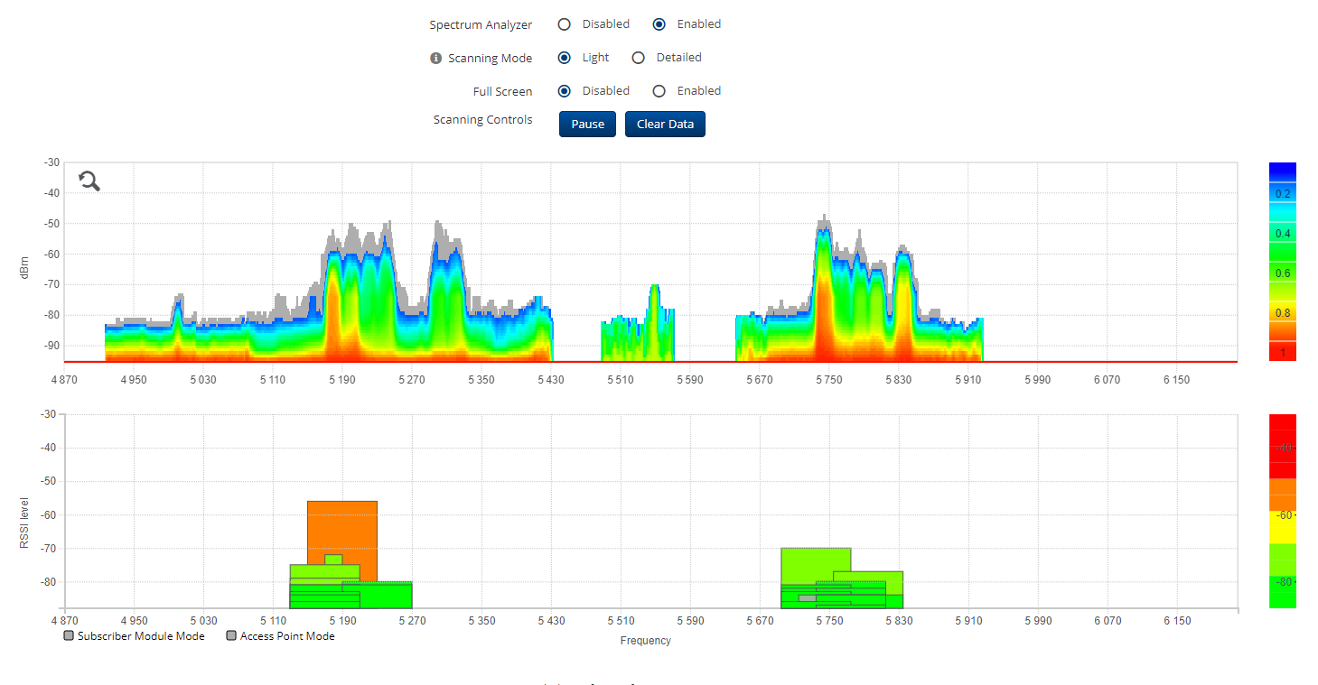

SA is complete trash. 2 days now to fire up a new micropop
Installed a new 3000/Kpp Omni Micropop… and as one would do I ran the SA to see what channels I could use for my Micropop. After about 20 minutes it wasn’t really showing anything, big gaps in the graph, I couldn’t even tell if it was still scanning or not. Was running 4.6.1 so I upgraded to beta v4.7 R14 again , after a couple of hours nothing usefull… found not a single “interferer” and again huge gaps in graph (never the same gaps , it’s just random where the gaps are) so I reboot , put it on detailed… nothing so again I rebooted tried again and after 24 hours this is all I have:
No customers connected so it has nothing to do. Micropop so right now no sync over power so I set it to CMM5 so it’s not even TX’ing , it’s doing nothing but running the SA… poorly.
I hate this interface so bad… there isn’t a single part of it that doesn’t fail in some meaningful way. Why can ePMP’s interface not even do simple basic crap that other vendors have had working for a decade or more ?
EDIT: So several hours later and it just keeps getting better…
Apparently if I drive out to the Micropop I should find a Centurylink router taped to my antenna… note that the top graph shows no such thing, not even in gray. As I type this, the centurylink router is still at +5 dBm while the top graph hasn’t changed.
There is an AP at 5490Mhz -85dBm on the bottom but no data at the top (SSID deez2nutz).
As far as I can tell it doesn’t show Subscriber Models at all because there is an F300-25 literally 30ft away pointing in the general direction of this AP (at an AP in the distance) at 5310Mhz x 20 and another F300-25 Subscriber 6 feet from this AP at 5600 x 20Mhz that isn’t showing up top or bottom.
There are 2 Cambium AP’s on a tower it can see that I’m pretty sure are showing up at the top in the 5300-5340Mhz range but on the bottom, nothing.
As I type this deez2nutz has jumped to -76dBm but still nothing in the top graph the bottom is still claiming the centurylink router is taped to my antenna but still nothing above -48 at the top. Well deez2nutz is now at -66 still nothing at all showing for it in the top graph.
The epmp interface just keeps getting more and more frustrating… how is this so hard ? OH OH, everything on the bottom graph just vanished… it has started over on the bottom but the top remains , unchanged… I’m not even sure the top is updating any more… how do you tell…

So over a week now, it’s stopped, started and restarted countless times. Currently
and then like 4 seconds after I looked at it and got the above

Clients constantly falling off AP so I think , hay, the SA has been running since the last reboot 74 days, 4 hours, 53 minutes, 39 seconds ago when we updated it to 4.7-RC14 ! Lets see what kind of helpful data it has collected !
Can’t even ID the Cambium APs right there on the tower with it… nothing , no idea what any of that stuff is…
Yep – sometimes after a long while, that list will sometimes populate with a bit of useful info… and just when I think “OH YAY, it’s actually populated with something!!!” and then the moment I think that, the list erases and restarts and it’s back to square one. And lots of red-errors with ‘Spectral Tools error’ still. I mean, ver 4.7-RC15 and still nothing even close to useful.
