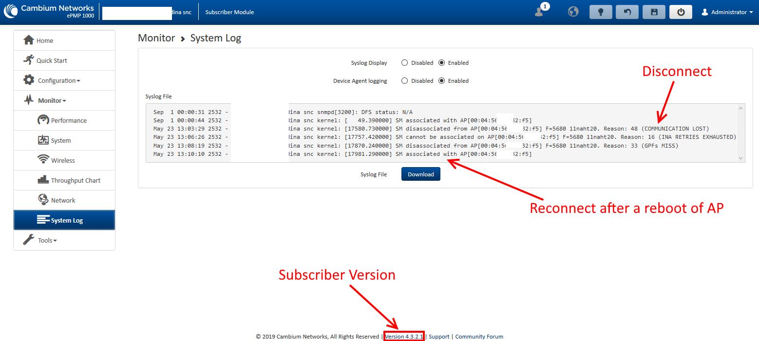

A few minutes ago, on a epmp1000-GpsSync with 3 users .. all dropped.
AP and all 3 subscribers with version 4.3.2.1
I attach a screen
So nothing is solved?
PS: after an AP reboot, all SMs go back online
I’ve also had this behavior in some particular situations… I’ve had to downgrade AP :frowning:
This is the log on a Subscriber
