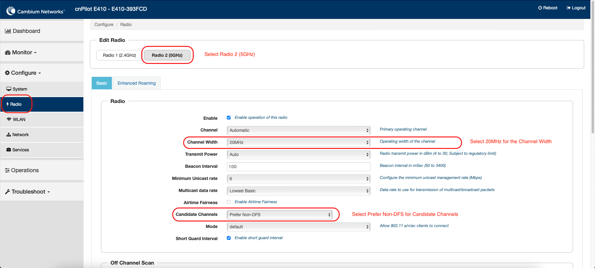

Two of several workarounds mentioned are
1 - Change the Channel Width to 20 MHz for the 5 GHz radio.
2 - Change the Candidates Channel list for the 5 GHz radio to prefer non-DFS channels.
I am including screenshots of cnMaestro and the Web GUI where you can change these values.
