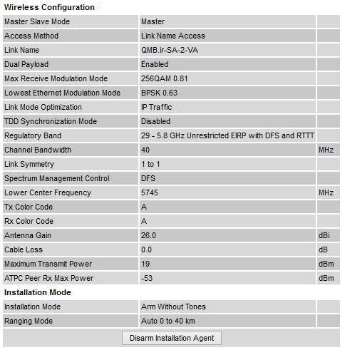

I have a ptp-650 link with lite license, in very low nois area with specification as below:
- link distance: about 1Km
- singnal strenght: -38dBm
- 26 dBi high performance dual polarization dish antenna
Our bandwith is very low, about 5Mbps. and modulation is fixed on bpsk and when i change it to other mode, after rebooting it return to bpsk again.
Please help meto fix it. How can i do to improve bandwith?
Thanks

Thank you Kevin.
Problem is solved by set the appropriate modulation mode & disarm instalation agent.
Before that, we change the modulation without disarming, therefore it's return to bpsk.
Thanks alot for your attention
