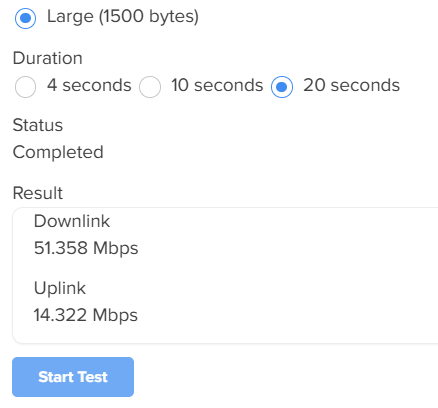

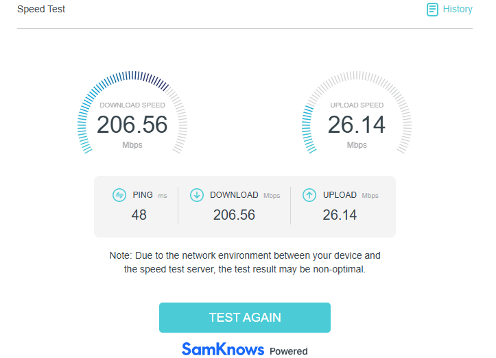

I am finding poor performance on a 4500 with a mix of 4525 and force 300 25 radios. I just installed a customer with a 4525, total users on AP, mix of stated above radios, is 15 and the most I could pull on new installed customer with 4525 was 61 mbps down and 21 mbps up on 20 mhz channel. On my e3K APs, using 20mhz channel, with force 300 25 I was easily hitting 75mbps down and 10 mbps up using 75/25 ratio, hell I even tested one customer with a force 300 25 for fun and he was able to pull close to 100mbps down in link test…..
4525 results….
not really impressed so far but hopefully it gets better. Oh and I am running 5.10.3

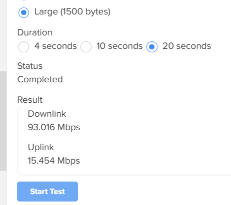

F300-25 Wireless link tests ~ 150Mbps download and / 48Mbps upload (I’d say that’s due to 40MHz upload)

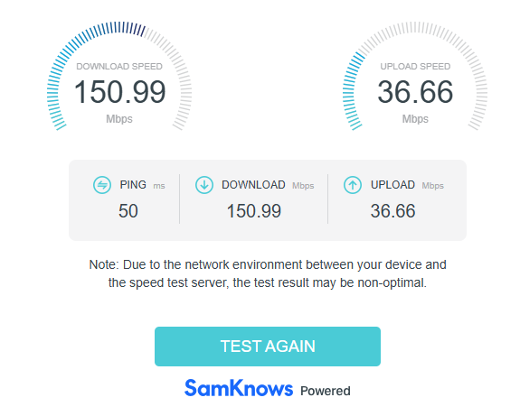

F4525L Wireless link tests ~ 269Mbps download and 38Mbps upload.

Speedtest.net on customer sites I’m seeing up to around 230Mbps. Remote router tests on the F4525L behind LibreQOS shaper
Same remote test on the F300-25
I do see a LOT more retransmissions on the F300-25’s. On the F4525L’s retransmissions are negligible. Stations are all in NAT mode.
