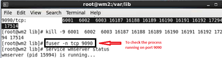

Solution: This is due to some processes are still running using TCP port 9090, so we have to stop them.
Below is the list of command to check the process ID using TCP 9090 and on how to kill those PID.
To check the process use command:
#fuser –n tcp 9090
To kill the process use command:
#kill -9 <pid-1 pid-2 pid-3 >  Add all the pid’s to the list
• Check the wmserver status and make sure the service is stopped.
#service wmserver status
• Start the service again
#service wmserver start
