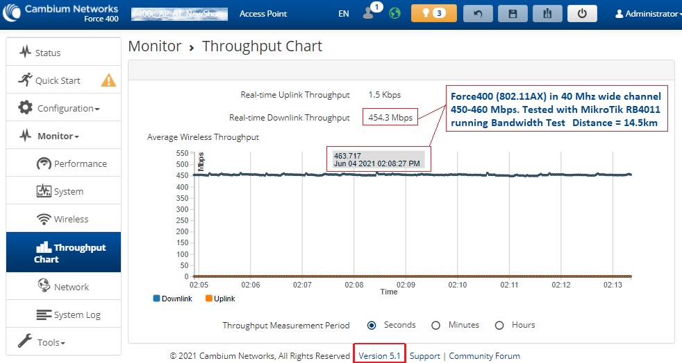

For reference - this is our link at 14.7 km, in 40Mhz mode, we get 450-460 Mbit through it (in 40Mhz mode) with most traffic going at MCS10 & MCS11
Here is a quick test of our F425 link in 80Mhz mode.
960+ Mbit throughput in 80Mhz mode.
F425-F425 965Mbit 80Mhz Fw5.1.1 June 2021

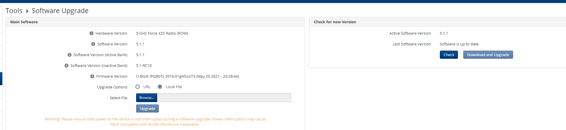

Btw, whats the cause of this?
is this some kind of gui glitch?
Yes, it’s.
It’s not 5.1.1 yet, isn’t it?
Thank you.
Ihave changed the firmware, howevcer, I may have downloaded the wrong file. Excuse me a sec, lemmi update it real quickl
I think ive got it correctly
both are 5.1.1
