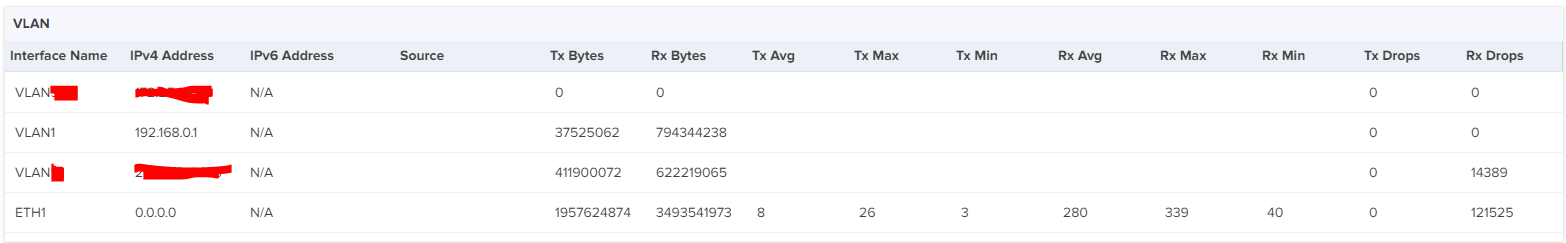

The same AP on cnMaestro at the same time:

Hi,
I do not see any Queues being filled up. Most probably, AP resource such as CPU, buffer usage is ruled out.
Could you please message packet capture to my ID when DROP counter increases.
Will diagnose the capture, and will let you know the updates.

Hi.
Counters on VLAN interface has already increased. It is constantly increasing per a few packets.
Will send you capture via PM.
