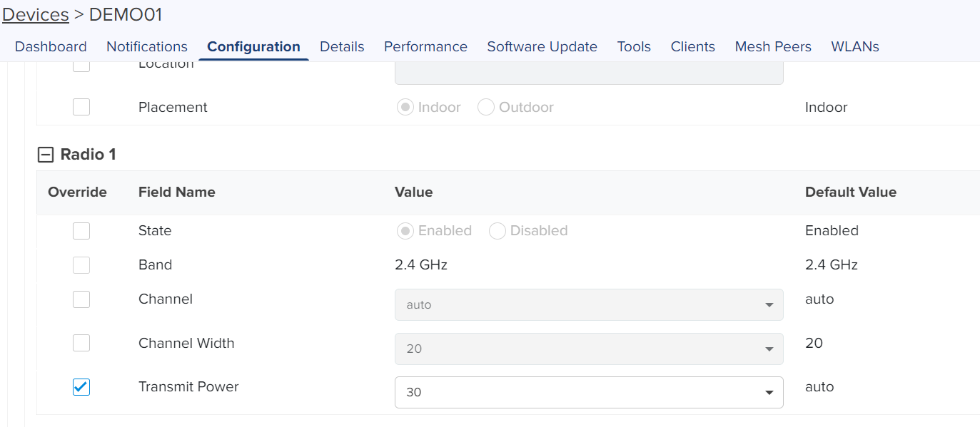

I have a question about transmission power.
AP consists of 5 units.
I set Transmit Power to “auto” from “AP Groups” > “Radio” in cnMaestro and set the transmit power of one AP individually to “30”, but the setting is not reflected, why?
Because you are at ETSI region not in US.
30 dbm - first is to high, sec not available on not ROW device.
2.4GHz is limited to 20dBm EIRP per ETSI Regulatory limits. The FCC allows up to 36dBm EIRP.
thank you for your answer.
As a result of various verification, it turned out that 13 or more can not be set.
