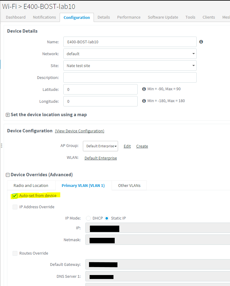

It sounds like the configuration being applied to the devices is causing the device to lose connectivity to cnMaestro. The configuration push then fails by timeout 5 minutes later and the device is marked Out of Sync. Is this correct? When this happens, the device will roll back to its previous configuration after 15 minutes in order to regain connectivity to cnMaestro.
If this is the case, I recommend reviewing the AP Group to ensure the network settings are valid. Then look at the device-level configuration page's "Device Overrides" section. Configuration set there will be applied to the device instead of the AP Group settings for that single device. In particular, verify the Primary VLAN settings. If "Auto-sync from device" is enabled, cnMaestro will read those network settings from the device and then push them back as part of the AP Group in order to prevent them from being changed.

For reference, below is a screenshot of the Device Overrides I was referring to earlier that includes the "Auto-set from device" option.
