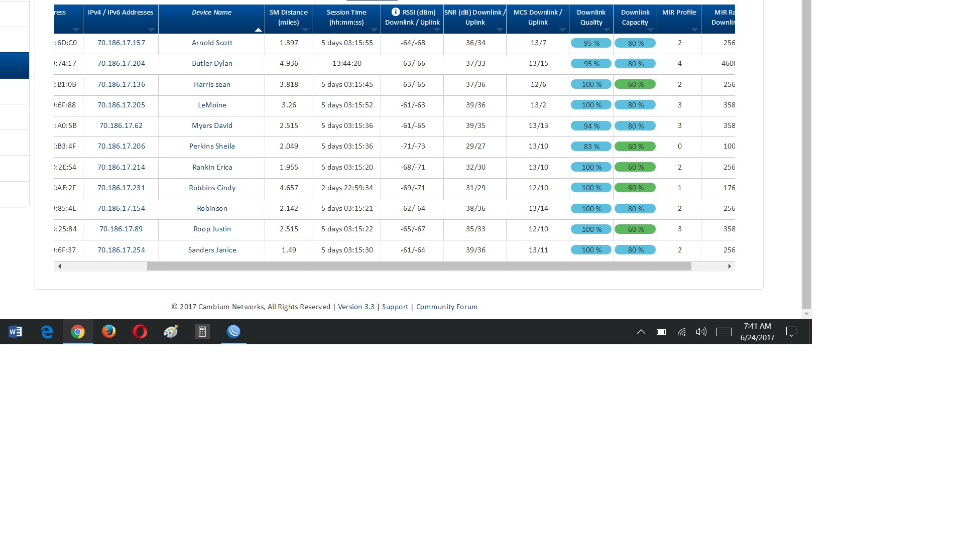

Hello All! Hope you are able to keep the majic smoke working on your network! Just thought I would post a Pic of a screen shot of the EPMP1000 AP I recently put up. (About 3 months ago) I am the Guy who would love to see Cambium develop the 24 OS to support channel filters like the 2000 5.8 Radios. We have the 2000 5.8 for our customers that have N (Near) LOS, the 1000 2.4-10MGz for our customers that have LN (Less Near) LOS, and we are fixing to roll out Baicells LTE for our true hard core N (NON) LOS customers. It would be awesome if the 2.4 1000 product would have the channel filtering I am convienced it would make ALL the difference in the performance. BTW we have 1 2.4 AP running 5MGz back to back with 1 running 10MGz GPS-TDD of coarse with NO issues. Much cheaper than the 900, more channel choices, more specturm, this is why I call 2.4 the "Forgotten" Freq. Thanks for letting me ramble. Remember: Keep the Lid closed so the majic smoke stays in! ~ R
