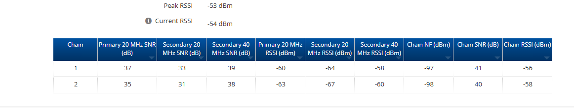

Is anyone experiencing “AP Keep Alive RX Struck” on 400c in a eptp setup? I am experiencing this randomly and I cant see it being interference, in the country/rural ptp link. Running 5.10.1,. here is the ealign tab of the AP of the ptp
Hi @DigitalMan2020,
To my knowledge, there have been no reported false Keep Alive Rx Stuck events in firmware versions 5.10.x or 5.11.0.
Could you please post the following:
• A screenshot of your Spectrum Analyzer running for 15 min
• Your MCS distribution from Performance page
Additionally, could you confirm whether you are observing any MCS drops in the statistics after 24 hours or more of operation?
