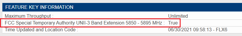

At the bottom of the general status page, do you see the “FCC Special Temporary Authority UNII-3 Band Extension 5850 - 5895 MHz” set to “True”?

Yeah, that’s because the feature key to unlock the 5.9-STA band extension for the NA/US region isn’t installed.
Once it connects to the AP, it adopts the region code of the AP, and those frequencies get greyed out. But normally loading STA firmware will set the feature key. In the case of a 450b6 there doesn’t seem to be any compatible FW that will do that.
