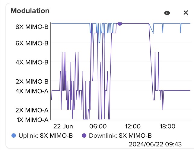

In the case of your graph - I usually see the same for two reasons:
  • Interference at the subscriber’s side. I have seen this when competitor’s APs are on the same or overlapping channel with mine and in a similar azimuth from the subscriber. It seems to happen when the competitor’s AP is busy.
  • Reflections or multipath. One of my installers for a while was installing the 450b radios a bit too close to reflective surfaces, like the wall of the house or the edge of the roof in the shot. Randomly, RX rates will crash and stick for minutes to days for no rhyme or reason. Moving the radio away from the reflective surface seems to usually resolve that problem permanently. The 450 radios seem very sensitive to this.
There is also another thread about v24.0 and RX rate crashes. That may be relevant if you have upgraded to 24.
Similar to your one - when it’s showing the modulation problems, the RSSI chain imbalance shoots up big time.
