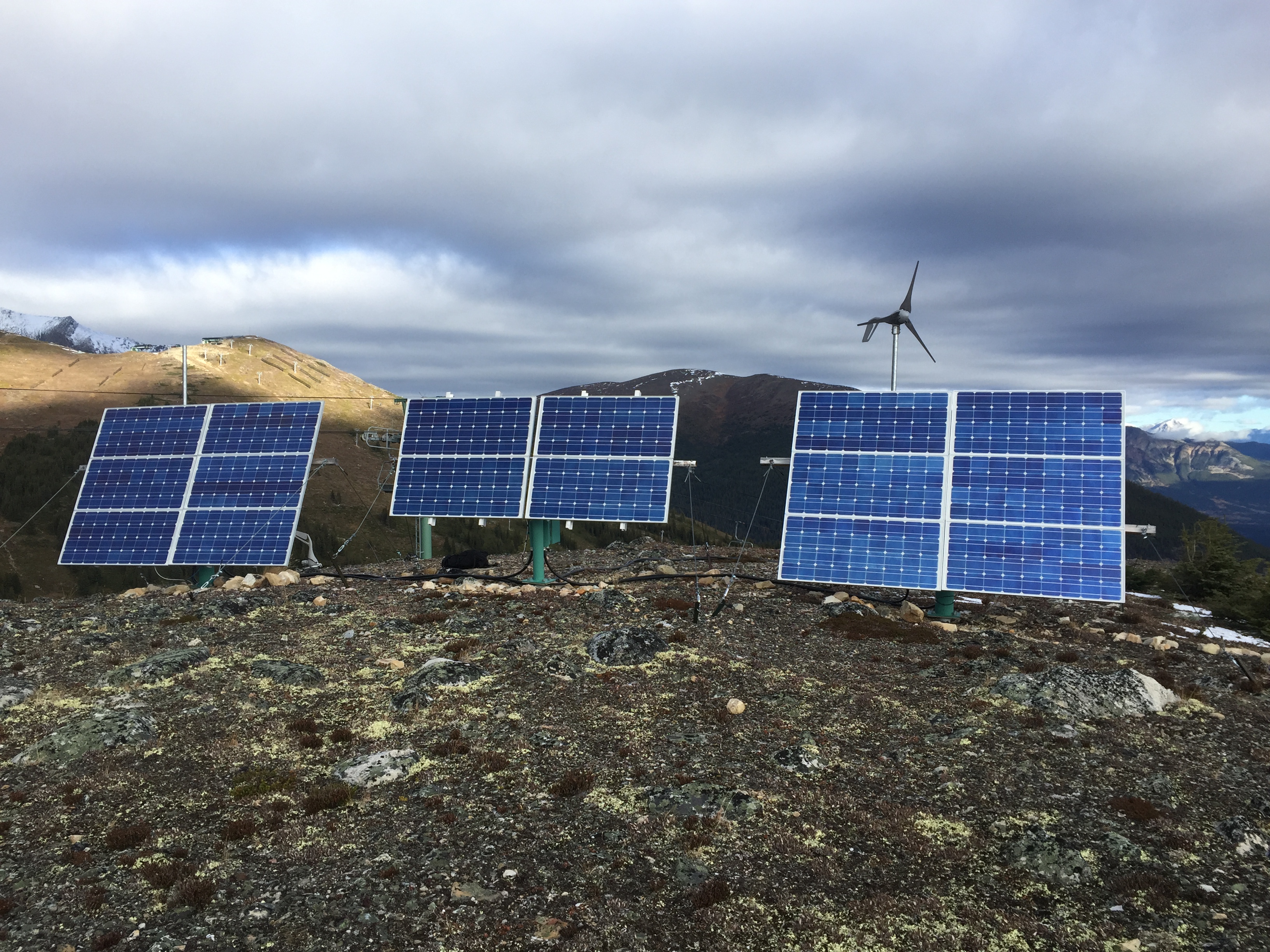

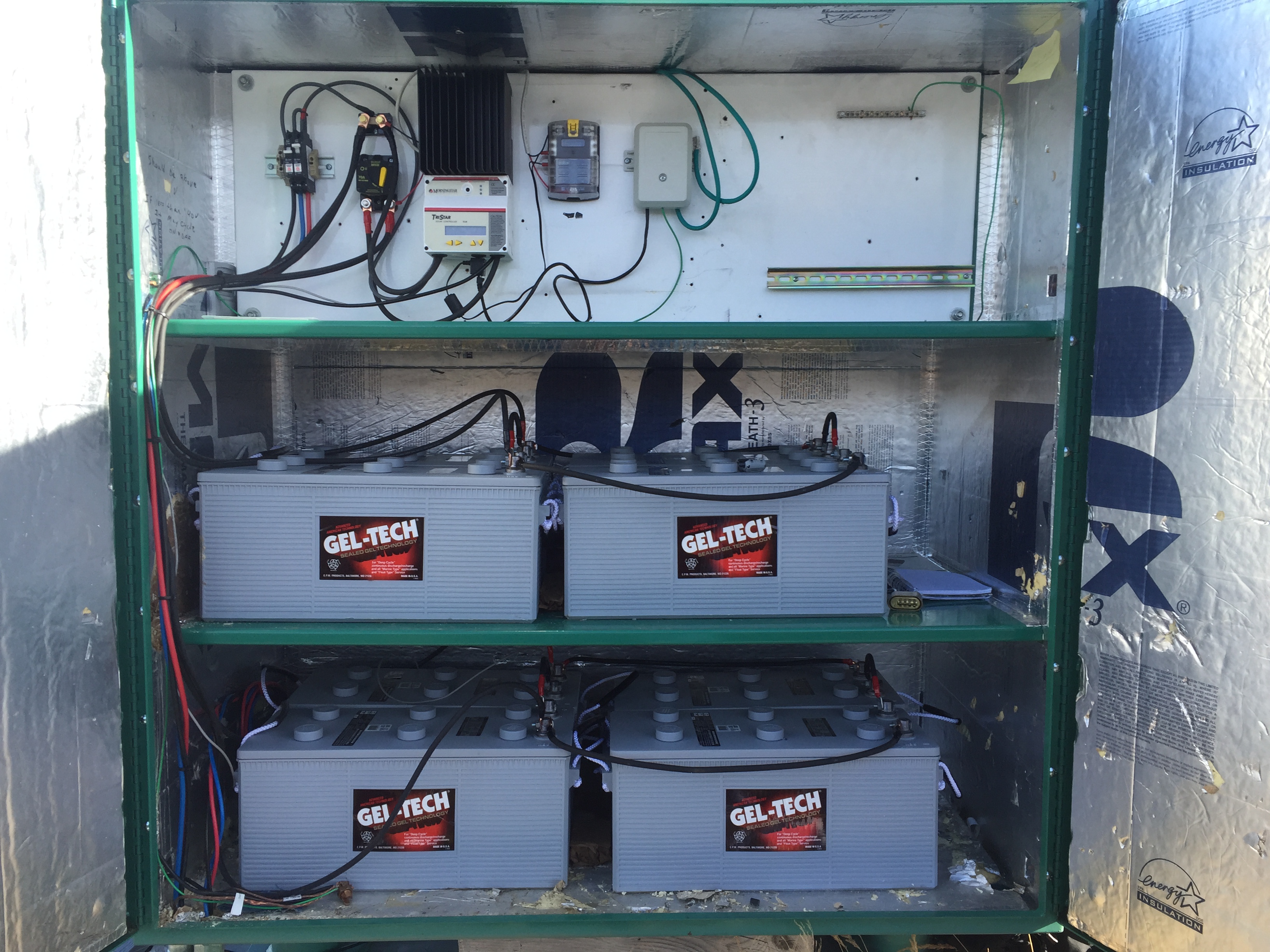

We have done the same. 24VDC battery bank, with a 24-48 converter for the 450i links. This is for a ski resort, so reliability was a must. We oversized the solar and bateries, and added a wind generator for backup. Better safe than no network on Christmas day. haha
The company previous to us built a 12 VDC battery bank, then added an inverter to power the AC power supplies that came with Redlines, which of course converted back to 48 VDC. haha Not very efficient. They also undersized the solar and batteries, and the maintenance guys had to run a generator to the site weekly. Our gear ran all winter without a single rereg. ;-)
**The photos were taken before the 24-48 was added for the 450i's.

Wow, that is a very nice set up. Any yea, you were'nt kidding about beefing up the solar and batteries. Are those 100W panels up there or 240+ watt panels?

Those are 170W panels. We have them wired as each set in series for 72 VDC, paralleled in a breaker enclosure, then down to the controller (long run of 8AWG over to one of the chair lift poles).
170 Watt panels, are those 24V? I think I need to run 260 watt panels at 24V each and then run them in series to create a 48V system that will feed a 48V battery set up. I don't know a lot about solar or electircal but your set up really looks great. This will help me with my design. Thanks for the input. very helpful.

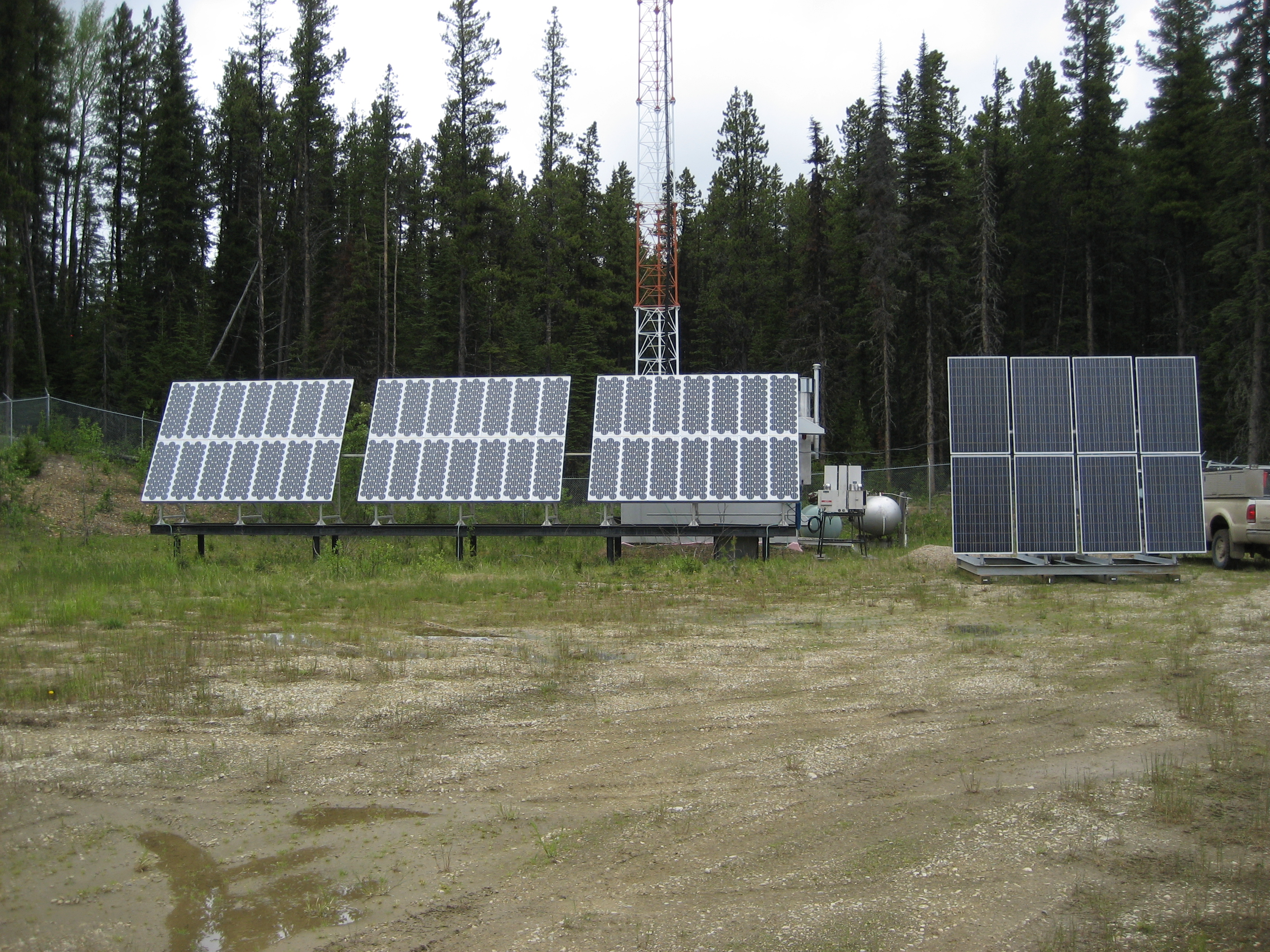

This is another we have done - the set on the right is all 240W panels, for a Canopy system (PMP100 2.4 GHz Cyclone AP and a PTP59600). This is more overkill. haha
The larger array on the left is older 140W panels, running a UHF SCADA system (most of that equipment is gone now).
