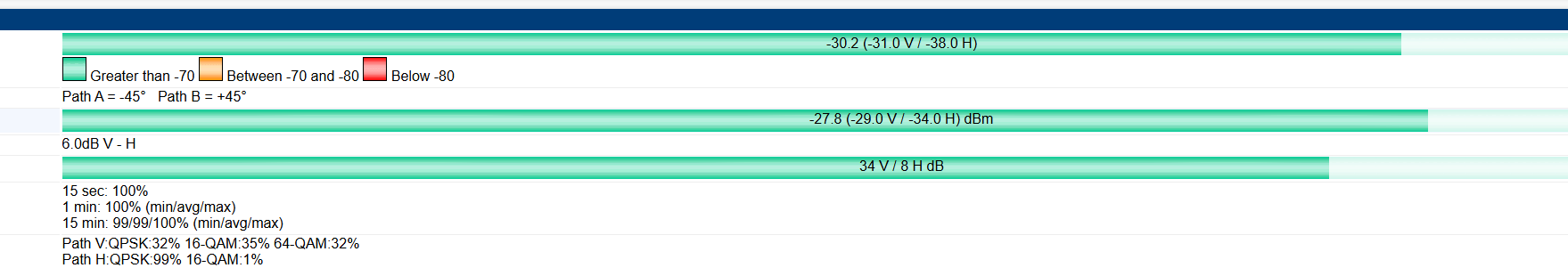

Screenshot 2026-06-24 060128
Did notice its H SNR has dropped
I find this interesting
Screenshot 2026-06-24 072235
The top has some trees in the line of sight but the bottom one is the one that I shared the alignment screen previously, crap stats but good signal.
The 450 platform really doesn’t like nNLOS, and reflections and multipath issues can cause wild swings in modulation or just poor modulation in general, despite having excellent RSSI/SnR. If you haven’t done so already, you should try enabling airtime fairness schedular on the AP, this may help to prevent those SM’s with poor modulation from impacting AP frame utilization.
Understood and thank you for your reply. What should I do with the one SM I pointed out that is 200meters from the AP, 100%. Clean LOS but has terrible link quality?
The SM is reporting an RSSI of -30, which is too strong. Try moving it out of optimal alignment to reduce the RSSI to something around -50 to -60 RSSi. See if that improves modulation.
